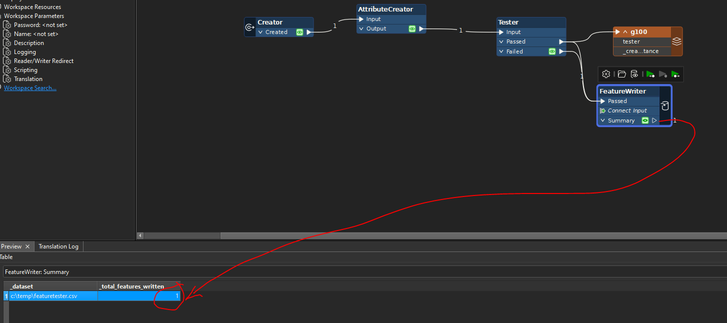

Hi ​@a.bradley I think the summary will give you just that. A summary count (including a 0 count) of features written….i think.

I think the NoFeaturesTester tells whether any FME features passed through the transformer or not?
https://hub.safe.com/publishers/safe-lab/transformers/nofeaturestester
