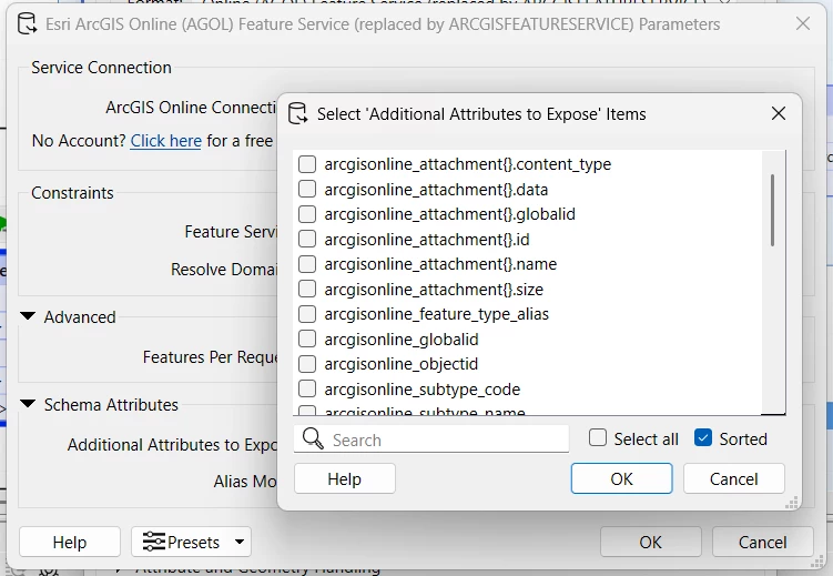

Why was exposing attachments removed in the ArcGIS Feature Service format!!??
Now we have this:
I have to use a separate transformer now to get attachments?
The new format is unbelievably painful to work with...

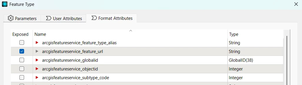

When I first came across the change I was confused as you are and asked the same question, but after asking ​@siennaatsafe how to use ArcGISAttachmentConnector I learned that what replaced the Expose attachments was very similar - you enable a format attribute in the reader to use downstream your workflow.
With the new feature service reader you expose the feature_url instead of the attachment.
new ESRI Feature Service reader

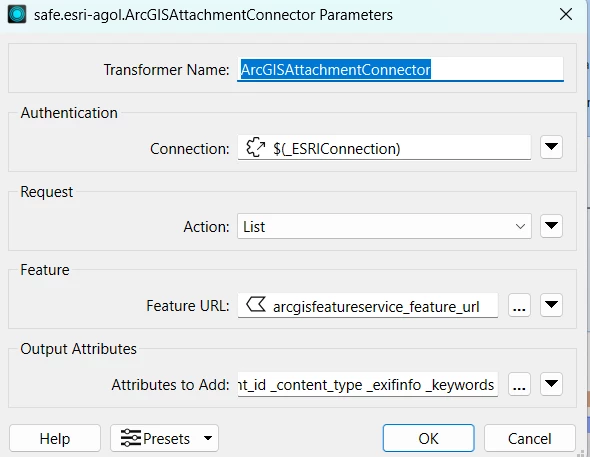

Once you have this enabled you add two of the Attachment Connectors similar to the below.
Download attachment workflow
The Action Item:List whowing the format attribute configured in the Feature URL parameter.
The change makes sense because an attachment is attached to a feature, and that feature url is part of the end point that queries the attachment. Once you have a feature URL, then you can do so much with attachments with simple configuration.
