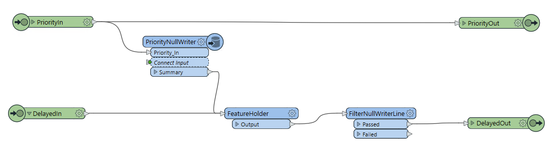

Making a rudimendary version of the sort of transformer I’m proposing in this idea isn’t too complicated and ends up looking like this:
The idea here is using a FeatureWriter as a proxy for knowing when the PriorityIn port closes, and not letting any features from DelayedIn through before then, but otherwise letting PriorityIn features flow freely, and ideally letting DelayedIn features flow just as freely once PriorityIn is closed (in practice, FeatureHolder actually blocks all DelayedIn features until the last one has arrived).
It wouldn’t be possible to make such a transformer with the 2024.0 Python changes alone, due to how close() is only called when all input ports have sent their “All done” signal, instead of having a separate close method that gets called for each port. Not being able to configure individual ports for bulk mode support is also going to be a problem, because DelayedIn features that come in early will probably need to be buffered until PriorityIn closes (which is illegal in bulk mode), but PriorityIn can still operate in bulk mode just fine, and in fact so can DelayedIn if PriorityIn is already closed by the time the first feature comes in.
