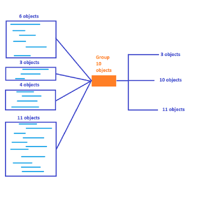

Dear FME Community,
I should to optimize my job, and for that I need to make group processing with an optimization of objects numbers like that :
And after, as you can see, make a parallelize of objets for not having only a linear treatment.
Do you know how can I do this ?
Thank you very much.

However, I cannot understand why 24 objects (4 groups, 6+3+4+11; left side of your screenshot) should become 27 objects (3 groups, 6+10+11; right side) after perfoeming "Group 10 objects" (center). Could you please explain how the "Group 10 objects" should work?

So I try to optimize my workbench with a group and parallel processing.
For the number of objects in a gorup, sorry, you’re right, this was a mistake I have corrected the picture.
So, I would like the process, optimize the groups of objects of 10 maximum and if a group is composed of about 11 objects, he take it in one group only.
