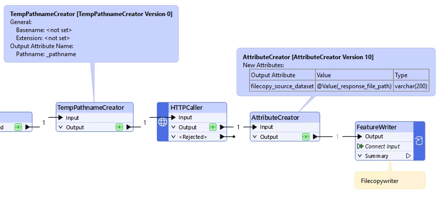

tisjadaggers
Forum|alt.badge.img+2
Is it also possible to extract a pdf from a website using the HTTPCaller, and then write the output to a folder using a separate writer?
I want to make a Data downloader in FME Flow, which requires the workspace to contain a writer. The HTTPCaller is not recognized as writer by FME Flow.
  • Aug 4, 2025 3:09 PM UTC
​@tisjadaggers - you can write the file to a temporary location, then use a filecopywriter to copy it, this will show up to use a data download
