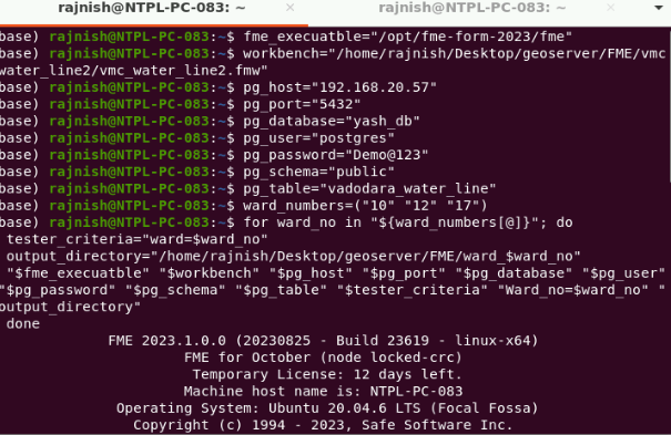

I have made fme workspace by using tester transformer, there I am using postgres table as input tester transformer for filtering , but now i want to run the workspace through shell script and want to send criteria for tester transformer by shell sc
  • November 10, 2023
  • 8 replies
  • 67 views
In a way through shell script I should be able to dynamically send the criteria that we apply in tester transformer for filtering the input data. How to do it.

Hello sir, thanks for the response. I have made the user parameter but I am facing problem, user parameter is not fetching the dynamic value that I am trying to apply through command line, it is only considering default value.command line

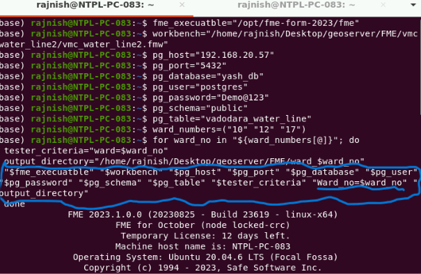

I'm not too familiar with Linux scripting, is there a way to show the exact command line?
Your workspace expects a parameter $ward to be passed to it and I can't quite see where that would happen in the script.

Hello sir,
Here I have made blue box there I am passing different parameters that I have mentioned in the above part of the script. At the Blue line inside the blue box I am trying to pass the user parameter value , I have made user parameter with name ward and here I am trying to dynamically provide the value to the user parameter by running the for loop on the ward_numbers array.
I hope this is clear sir.
sorry for bad drawing.
  • November 21, 2023
sorry user parameter name is not ward it is Ward_no.

Okay, so then you must make sure it's named Ward_no in the workspace.
