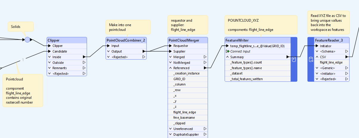

Hi ​@james_c_452 and ​@evieatsafe
I was playing around with this as well as I needed this for a shadow analysis. In short the case: with a raster DEM and some solids of buildings and trees we wanted to find out which pixels would be in the sun/shade at a certain time. We transformed the raster into sunrays and those into a pointcloud. Clip with the solids and in theory you know which DEM pixels are in the shade (those clipped by the solids). We stored orignal pixels number in component ‘flight_line_edge'.
But connecting the clipped pointcloud to the original pixels turned out to be quite hard. In the end I solved it thanks to this article with the pointcloudmerger (requestor = supplier). The key was writing to a Pointcloud_XYZ writer and reading that back in as a CSV.
With the original pixel stored as a component you can write that component to an XYZ file. When you read it back in as a CSV (super fast by the way) you have your distinct values as features.
Just thought it might help someone else 😊
