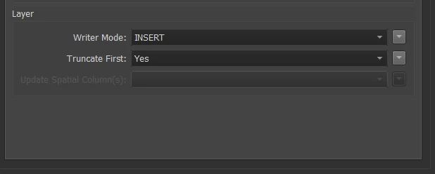

In terms of the error you are seeing I am wondering which writer you are using. If I take a look at the Esri ArcGIS Portal Feature Service I can just use the mode INSERT and set Truncate First to Yes
Settings in my FeatureWriter transformer
But beware this can be very slow. If your layer is referenced(i.e. not hosted) it's way faster to do these operations directly on the dataset.
