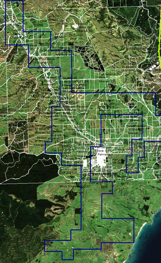

The steps to follow when extracting a feature layer from the attached screenshot polygon.

I want to extract data within the masked polygon by using FME. Can you please guide me how it should be done. Which transformer to use?

Take a look at this article: it talks about how to use the clipper. This should be pretty comparable to your desired workflow: https://community.safe.com/s/article/example-using-the-clipper-transformer
