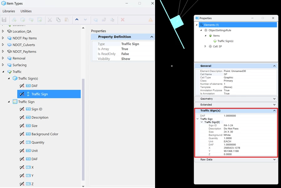

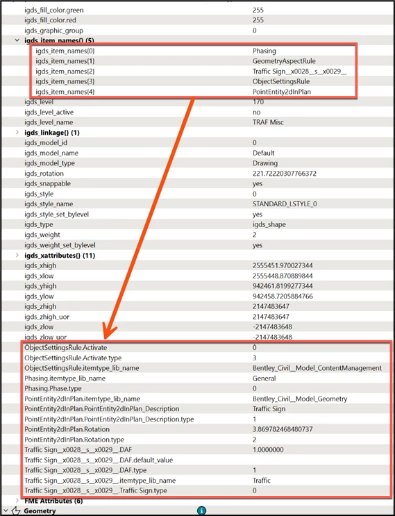

I have dgn file with elements showing like the following. Does anyone know how to read in the Traffic Sign item details in FME? I only be able to get in some item type info, but not the details.
Any help is appreciated.
Item type in MicroStation
element attributes in FME (read with Bentley MicroStation Design (V8) Reader)
