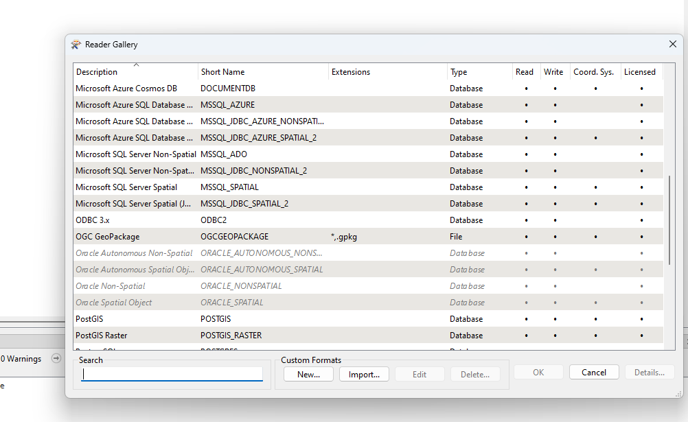

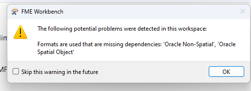

I installed FME 2022.1.1 on my laptop and installed the Oracle client (11_2) but even after several reboots I cannot select any Oracle Database as reader. They are all greyed out. When I open a workbench that contains Oracle it says something about missing dependencies: ‘Oracle Non-Spatial’,Oracle Spatial Object’.
When I want to run it, it fails and gives the error: ORACLE Home is not set.

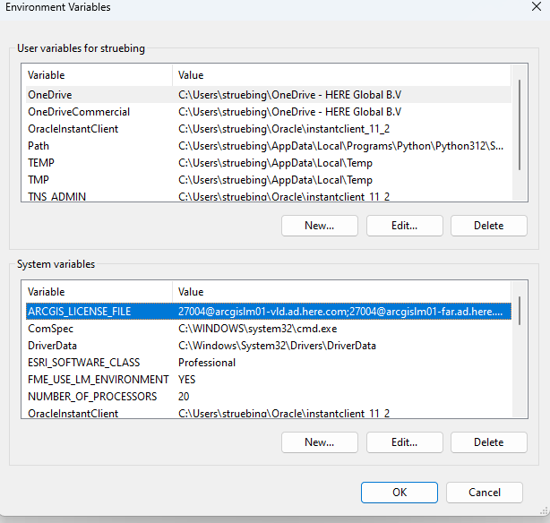

Your last screenshot mentions OracleInstantClient 11.2. That is a pretty old version, which is probably not compatible with your Oracle database. Can you try installing a more recent OracleInstantClient (23.4, 21.14, 19.23)?

I found the issue. I had to set the Path in the variables as well. I did not had to do that on my older laptop. So, I missed it. Now, FME is working with Oracle.
