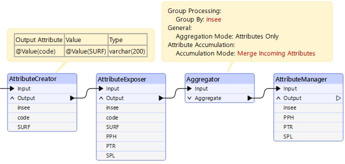

If it's correct, the following procedure could help you.
  1. AttributeManager: Create new attribute whose name is the value of “code” and whose value is the value of “SURF”
  2. AttributeExposer: Expost the new attributes names - i.e. “PTR”, “PPH”, etc.
  3. Aggregator (Group By: insee, Accumulation Mode: Merge Incoming Attribute): Aggregate the input features grouping by “insee”.
  4. AttributeManager: Remove unnecessary attributes.
The data flow looks like this.
