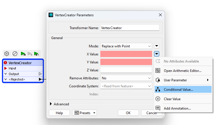

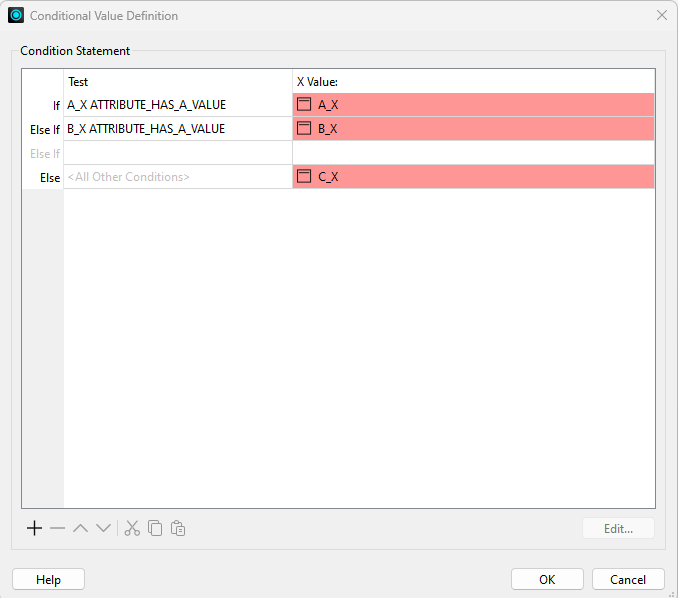

max_h
Forum|alt.badge.img+39
  • Apr 22, 2025 5:23 AM UTC
Can you explain this further for me? What do you mean with rename the coordinates? Like dataset_A_X and dataset_B_Y? And how do I create a vertex? Like if dataset_B_X and Y are present create a vertex? Thanks!
Yes, exactly. You can use an coordinate extractor to get the coordinates and then an attribute exposer to show them as attributes, which you then rename according to the dataset, so once you merge/snap/whatever you know for each feature the original A,B,C coordinates.
A VertexCreator can be used to create new points:
But I’m glad the suggested anchoredsnapper worked for you.
