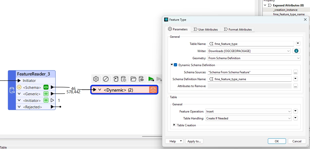

I have a very simple workbench that is cliping a gpkg containing mulitple layer. I am struggling with writinng them back to one gpkg using dynamic schema.
it fails every single time

Thank you for the tip but the error is

Hi ​@marta.podsiad,
Thank you for posting your question on the FME Community!
As a first step, could you try setting Schema Definition Name to fme_feature_type? Please try running the workspace again and let me know if the issue persists. I’m happy to continue troubleshooting this with you!
