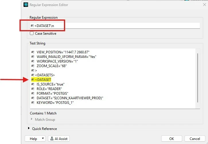

I try to find a text ending with a newline. Using the inbuilt regular expression editor (with the regex #! <DATASET\n) shows a result so the regex looks correct to me:

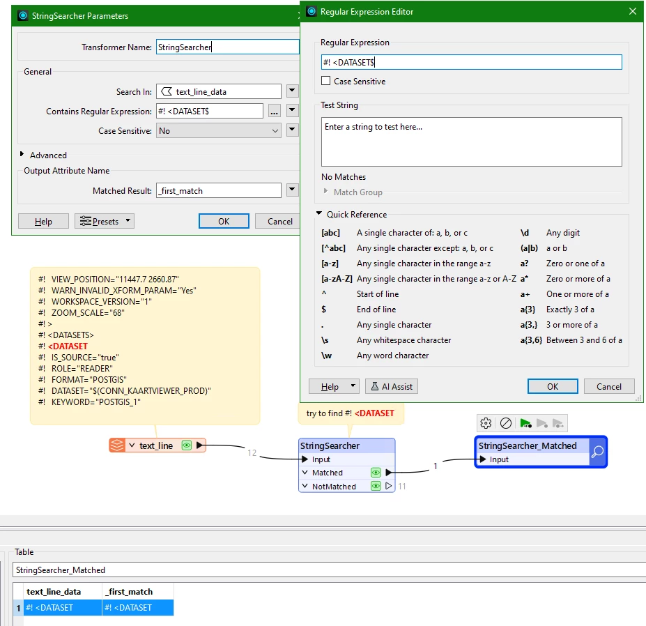

StringSearcher unfortunately doesn’t find the line: (see attached workbench)
Where are things going wrong?

Use $ instead of \n for ‘End of line’.

Thanks a lot geomancer 👌!
