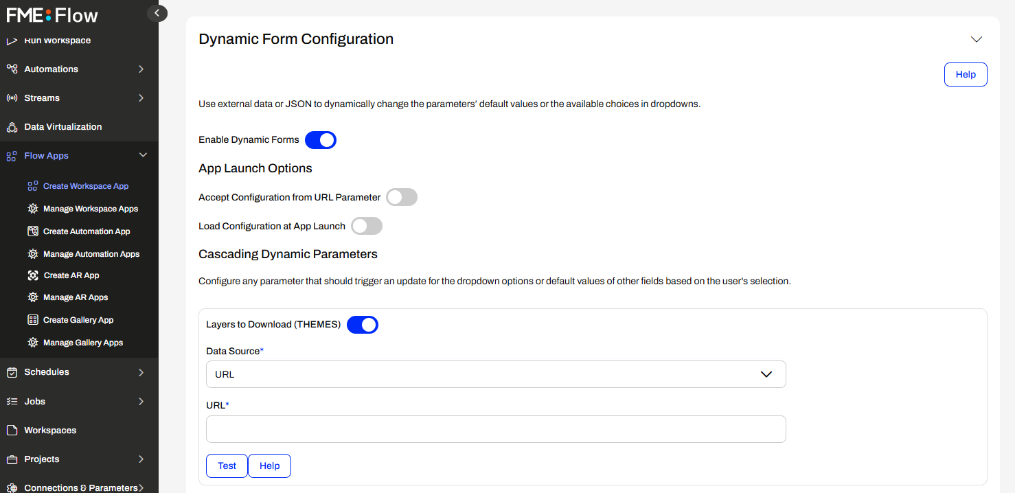

You might be interested in a new undocumented FME Flow feature present in 2025.1 beta b25583 :
Thanks ​@alexbiz
Our servers are still 2022, so I’ll need to defer this to when they’re being upgraded.
