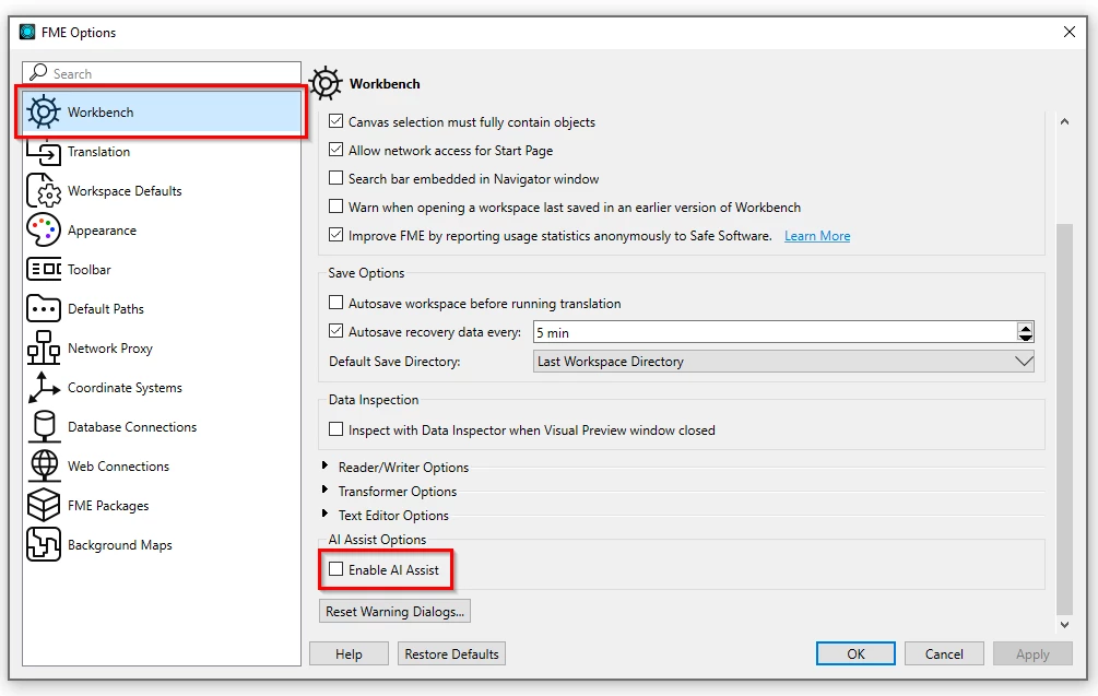

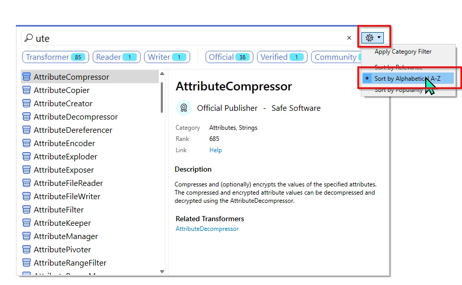

Hi, for what it's worth: we're experiencing a significant delay in the GUI when Quick Adding transformers (several seconds, sometimes per character entered). If you disable the AI Assist Options in "Tools>FME Options," "Workbench" tab, and set the sort order to Alphabetical in Quick Add settings (the wheel in the menu that appears after the first letter of the transformer), it's much faster.
