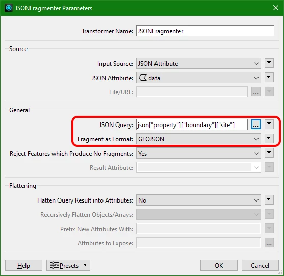

You can also use the JSONFragmenter:
JSON Query: json["property"]["boundary"]["site"]

Thanks ​@geomancer . In the Fragmenter if I choose Data from the JSON attribute I have four options. In your screenshot you went with just data, but it looks like I have to choose one of the four options.

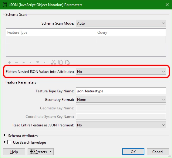

It looks like you are trying to use the JSON Fragmenter with the JSON reader. If you using the fragmenter you want to read the json as text

I had set Flatten Nested JSON Values into Attributes to 'No’. Forgot to menion that...

Did you set Fragment as Format to GEOJSON?
Did you add json in front of the JSON Query?
See the attached workspace (FME 2024.1, I don't have access to version 2023 at the moment).

I suppose ["data”] in your JSON Query is superfluous, as you are already inside “data”.
