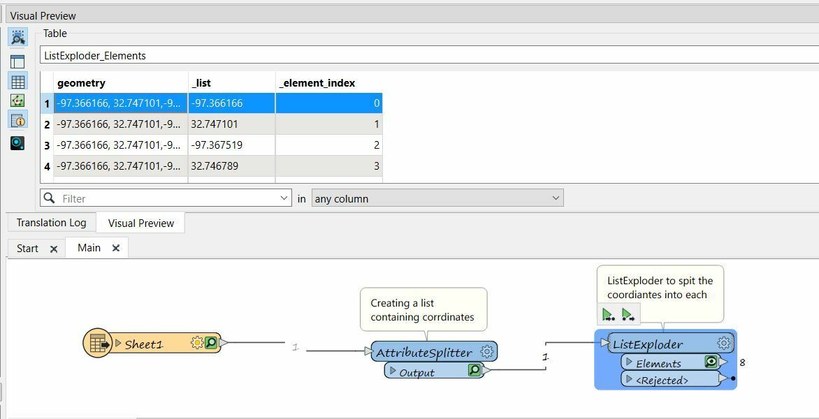

I had a pair of coordinates stored in a single column named "geometry." I used the Attribute Splitter to separate these coordinates and then exploded the list. Now, I have each latitude and longitude in the same column. Is there a way to copy these latitude and longitude values into separate columns labeled "Latitude" and "Longitude" while maintaining the same order?

Sure! here is the data i read in an excel format in my workspace:
geometry
-97.366166, 32.747101,-97.367519, 32.746789, -97.369184, 32.746717,-97.369023, 32.748890
I have also attached the screenshot of my workspace.

Separate the List Index integers into Odds and Evens using fmod() in a Tester.
Then can rename it to LONG an d LAT value attributes and merge them back together with FeatureJoiner.
