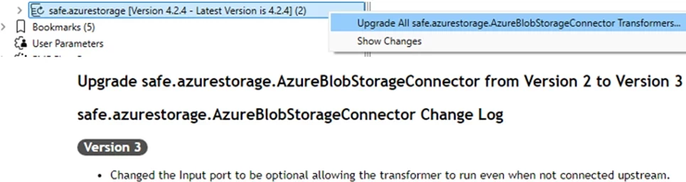

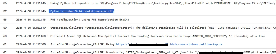

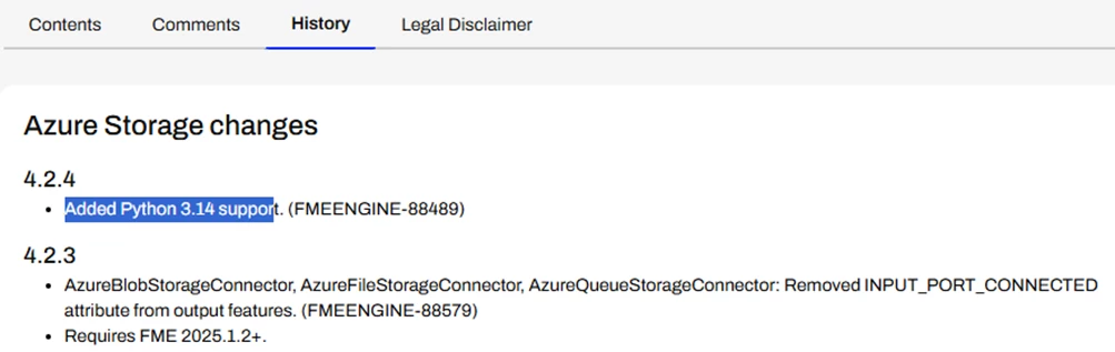

In performing an FME version upgrade, you definitely need to account for updating FME packages, that is %Connector hub transformers POST INSTALLATION
Between FME2024.1 and 2026.1 we have AzureBlobStorageConnector jump from v2.0 to v4.24 in FME Form
python compatibility Connector needs to match supported libraries in Flow
After upgrading the package in FME Form, you also have option to do the transformer
Don’t forget to upload these connectors and their packages and overwrite previous ones in FME Flow
Upload the package 4.24 to replace package 2.0
Check the transaction log detail
