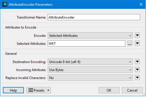

The log shows the encoding of the WKT as UTF-16LE. Recent versions of FME have had some issues with attributes in that encoding, especially on Macs. These issues are being fixed for FME 2025.2, but for now, please try using an AttributeEncoder transformer to force the WKT to UTF-8 before the GeometryReplacer:
That does solve it, except for one single feature which remains rejected (WKT attribute for that one contains only a P). So for now I am staying with my own workaround, selecting both WKT and WKB, and using the WKB when any feature is coming out the Rejected-port of the GeometryReplacer. Because that allows me to have every feature coming through.
