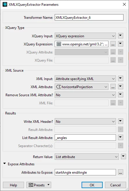

I use several XMLXQueryExtractors in my workspace, each with queries similar to the example below. Sometimes a query returns no results, which causes the transformer to generate a warning. This leads to a lot of unnecessary log entries and clutters the log.
I’ve tried checking whether the query returns a result before processing it, but the check still sometimes evaluates to “no result.”
Does anyone know how to prevent these warnings? Could it be related to the fact that return only uses fme:set-attribute and therefore doesn’t actually return a value?

Settings from the transformer

Best answer by debbiatsafe
Hi ​@matthieuv
It may be the empty else statements in the XQuery expression that is causing the entire expression to be output to the log file.
When $arc evaluates to false because it is an empty sequence, the else statement is run and returns an empty sequence. It is possible to avoid the extra logging by setting something like this:
else (fme:set-attribute("startAngle",xsi:nil))
Attached is an example workspace demonstrating this approach. I hope this helps!

matthieuv
Forum|alt.badge.img+30
  • Dec 9, 2025 10:25 AM UTC
Thank you Debbi! Adding xsi:nil to the output works perfect.
