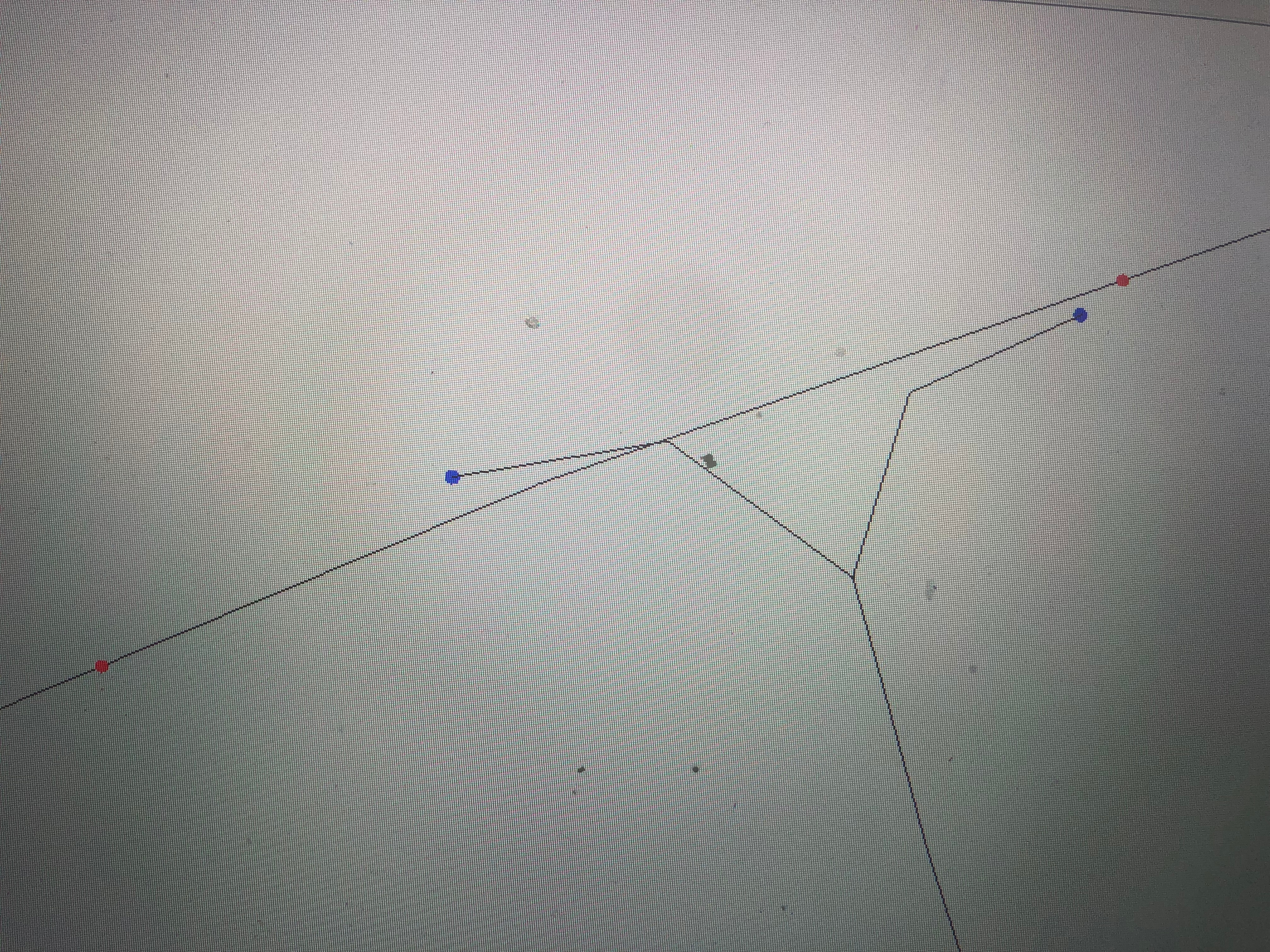

Green line is Candidate, blue is Anchor, red is modified section of Candidate, dots show line vertices
Segment snapping will snap the Candidate vertices to the nearest Anchor line or segment within the Snapping Distance, even if there is no Anchor vertex at that location:
We can see from this example that the distance from the Candidate to the nearest Anchor segment is shorter than the distance to the nearest Anchor endpoint, and so is more likely to fall within the Snapping Distance.
This option will snap to the Anchor while leaving all the original Candidate vertices untouched.
