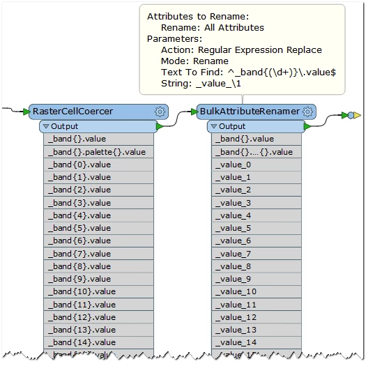

Got it, it's just annoying indeed.
It could be a workaround if you have exposed the list elements under the RasterCellCoercer and set All Attributes to the Rename parameter in the BulkAttributeRenamer with the Regular Expression Replace action.
See my solution in this Q&A;: How to change List to attribute (with ListIndexer transformer loop or another way)?
Example:
This worked :-)
In RasterCellCoercer, I did a right-click on the attributes under Output to choose "Expose Attributes". This gave me all the bands in numerical order.
Then in BulkAttributeRenamer I followed your advice to rename the attributes nicely.
But I think the critical step was "Expose Attributes" in RasterCellCoercer.
Thank you takashi
Example:
Specifically, in RasterCellCoercer I right-clicked on "_band{}.value" and chose "Expose Elements"
