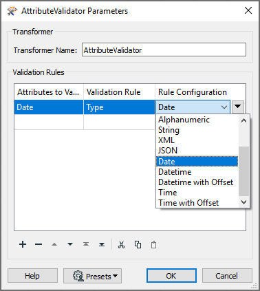

That is a great point @egomm & @david_r!
I did a little searching in our system and found out that validation for dates was actually added to the AttributeValidator in FME 2019.0!
Fantastic! :-D
