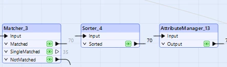

My data is going trough a Matcher to find features that belong to the same object. I then sort them on _match_id and an attribute called lighted.
Result of Sorter_4
As a result I have something above. If lighted is null it will be the first feature.

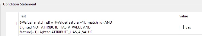

In the AttributeManager I use Adjacent Features to look 1 feature further and have the following condition statement for a new attribute called _filter. The second one is another attempt to get the same result, but that also doesn't work.

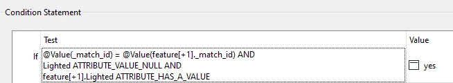

Alternative conditional statement I tried
I expect the two <null> values in the screenshot above to get the value ‘yes’, but it doesn't. What am I missing here?
Best answer by itsmatt
Possibly a case issue? I see in statements you are using “Lighted” but in the data screens shot its “lighted” with a lower case “L”.

  • Sep 25, 2025 9:08 AM UTC
Can't believe I missed that 😮
But also a little bit strange that FME doesn't say the attribute Lighted doesn't exist.
