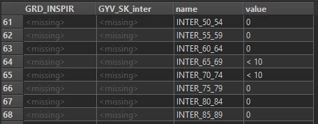

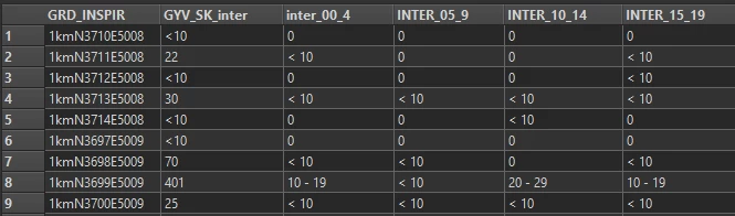

I need to transpose some of the attributes (with prefix "INTER"), but keep the other ones not transposed.
Original data looks like this:
The result should look like this:
Except not transposed attributes should have values. Obviously AtributeExploder doesn't do the job in this case. How can it be done?
Best answer by ebygomm
There's the option to Keep Attributes in the AttributeExploder
  • Feb 26, 2020 1:41 PM UTC
