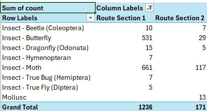

Also below an screenshot of the requested output which a excel pivot table:

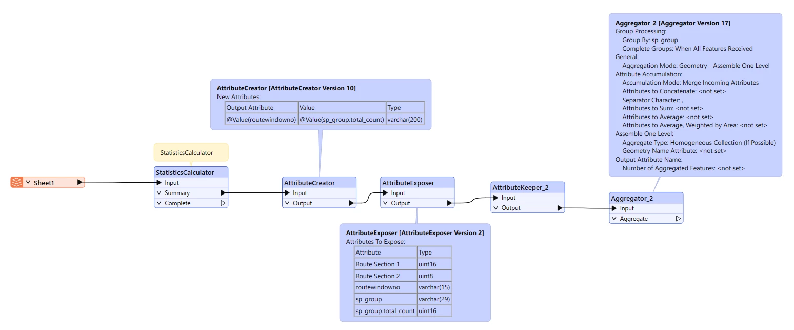

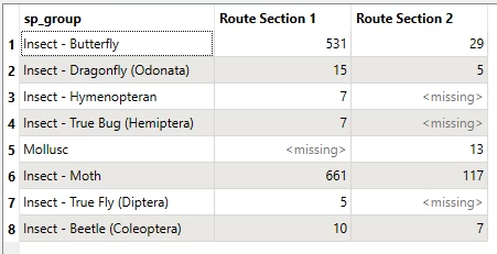

Alternatively, I was able to achieve the requested pivot table by adding the following transformers:
  • StatisticsCalculator
  • AttributeCreator
  • AttributeExposer
  • AttributeKeeper
  • Aggregator
Attached the template for reference, below an example of the final output:
I hope this is helpful to anyone who needs it
