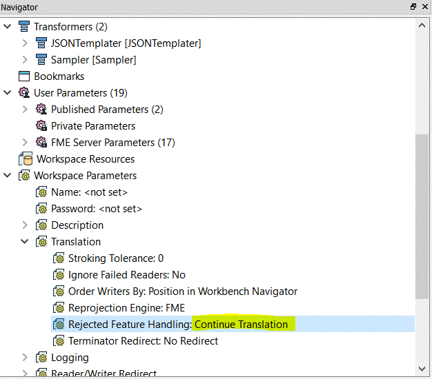

Hi @cmcnamara
You can change the option on Navigator to Continue Translation:
Thanks,

Hi @cmcnamara
Thanks,
Danilo
Thanks! I've got 100 workspaces, so I'm hoping not to have to manually update them all - they all changed to Continue and I want Terminate.
