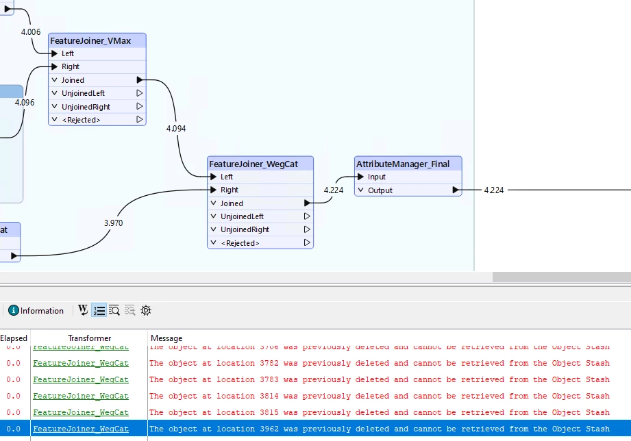

Same here.
Two FeatureJoiners, and lots of errors from the second FeatureJoiner:
The object at location ___ was previously deleted and cannot be retrieved from the Object Stash
Doesn't seem to affect the results.
I get this error on both FME Form and FME Flow (both 2024.1.3 Build 24627), so I would not expect the error to be related to feature caching.
Both FeatureJoiners are set to Join Mode: Left.
