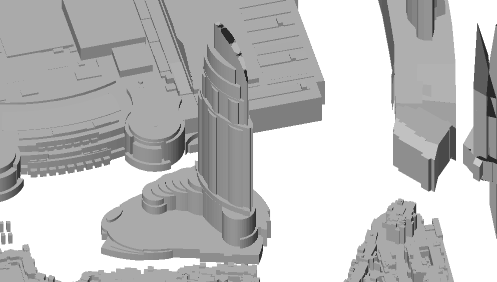

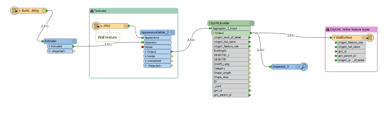

I am trying to apply texture for the building , it looks fine in FME inspector . If I try to open in FZK Viewer texture is not applied to the building. I also set the texture property in FZK viewer to "Entity".
Please find the relative snapshots.

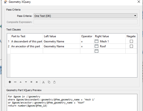

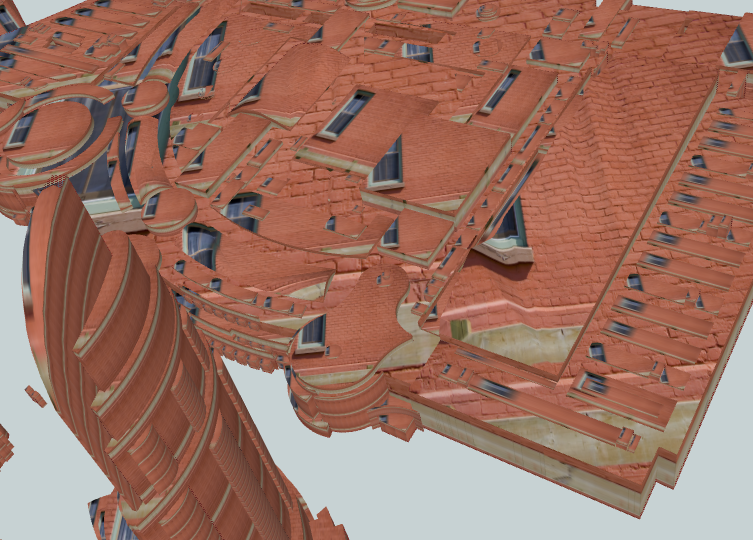

Hi,
Any solution to resolve this issue?
In my case it was adding more to the xquery in the apperancesetter...to force it further down. This was for a fbx output where I was applying a roof texture and my xquery ended up being:
kumarkannan1980
Participant
Forum|alt.badge.img+6
Thanks Davis, It works for me..
