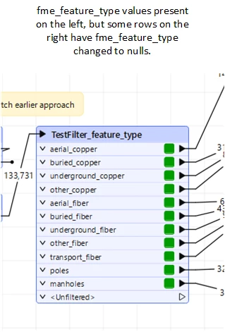

I recently tried to update an older workspace with a TestFilter that is used to branch data out using basic logic. After the update, the workspace failed in an odd fashion and after a bit of troubleshooting it turned out that one of the tested attributes, “fme_feature_type” in this case, was getting changed to nulls for many, but not all of the resulting rows. The change was from TestFilter Version 2 to Version 3. Has anyone else experienced anything similar? I’m running FME Form Build 25815.

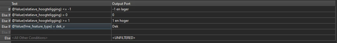

I was looking around on the forum for answers because I have the same issue: the Testfilter is setting fme_feature_type to missing(null in your case). Not for all rows, just “some” of them.
After some testing I have found two solutions:
  • First you could precede the step with AttributeEncoder and set it all to UTF-8. It worked for me then.
  • However I would try to remove fme_feature_type from the testfilter. In my case I had testing done on two different fields. One of which was fme_feature_type. After removing fme_feature type from the TestFilter and adding another TestFilter with the tests on fme_feature_type it worked! There were no more missing fme_feature_type fields.
​@jamatsafe It seems the TestFilter has some unintended behaviour when integrating fme_feature_type as a test parameter.
All testing was done in FME(R) 2025.1.2.0 (20250829 - Build 25630 - WIN64)
All transformers are updated to their latest version
The test condintions above cause the unintended behaviour. Removing the fme_feature_type else if row fixes the issue. It doesn't matter where in the else if order the row is. The answer is the same.
