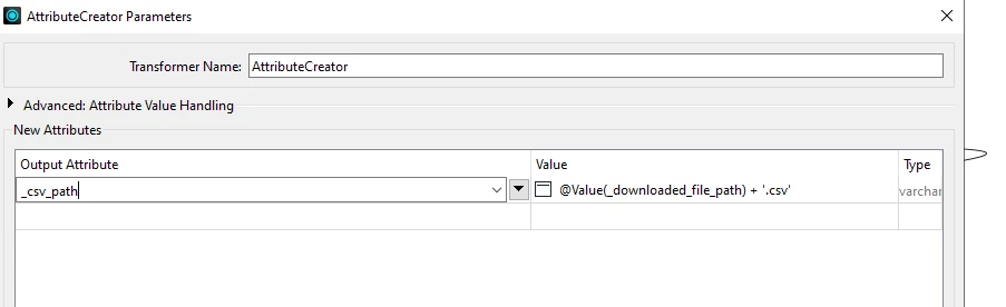

I am taking the _downloaded_file_path from the FTPCaller, and adding “.csv” to it, so that it reads the file. (There is a separate transformer which replaces the file with a file of the same name to add .csv). In the workspace logs, it looks like SystemCaller is interpreting this literally as Filename + ‘.csv’ and that file does not exist.

The value you’ve entered will output:
c:\temp\file + '.csv'
FME treats the contents of that field literally - @ is used as an escape/special character.
To append ‘.csv’ you would simply need:
@Value(_downloaded_file_path).csv
