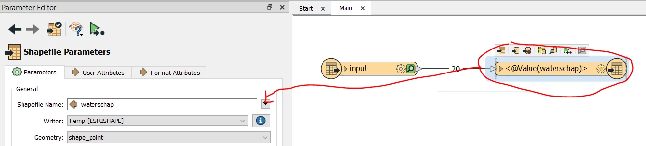

I saw this fanout and read about it but I can't just check it. It needs an expression. I don't have the time to train myself with FME during months. So please give me exact instructions what to do. Is that so terribly complicated? Its just a simple task I am asking for. What expression I need to add into this fanout field?
The fanout works on an expression or an attribute value or a combination of the two.
Since you are interested in the subcategories and they are all present in 1 attribute then I suggest using the attribute for the fanout.
See attached template, this will produce 2 different shapefiles since there are 2 distinct values in the attribute (waterschap) used in the fanout
shapefile2esrishape.fmwt
