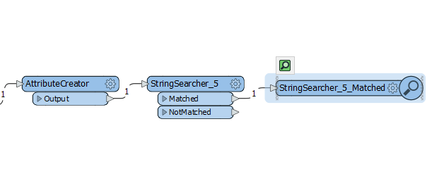

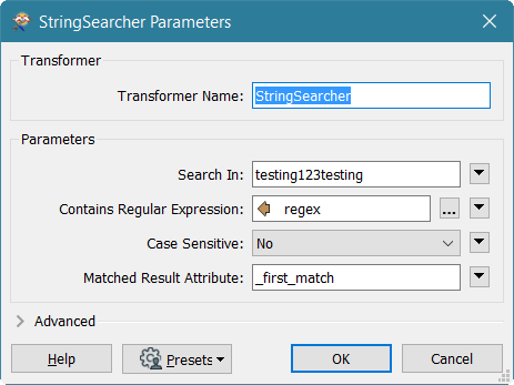

Seems to work just fine with FME 2019.1:
My regex contains "\\d+" and as a result _first_match contains "123", as expected.
Can you perhaps post a minimal workspace that reproduces the issue.

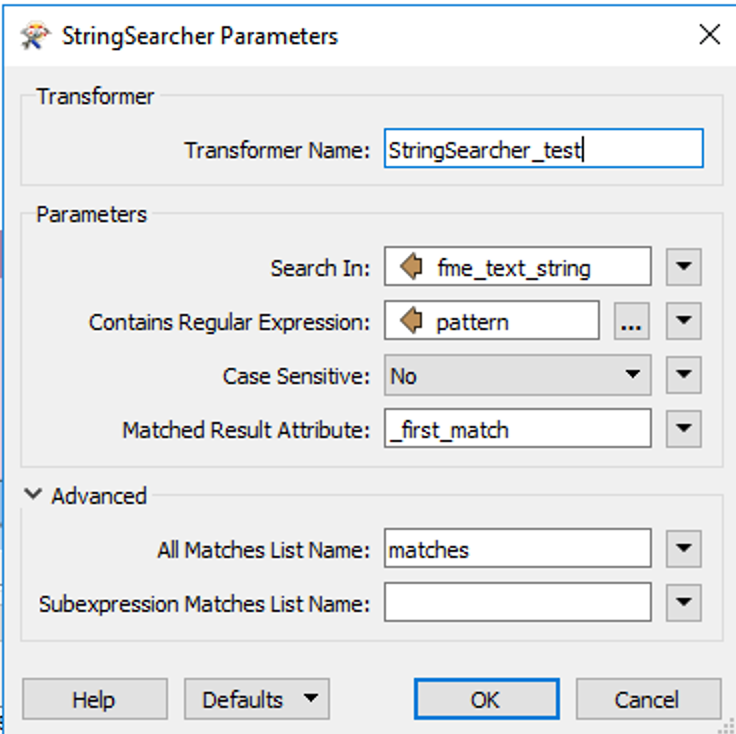

This is my StringSearcher.
I use FME 2018.1

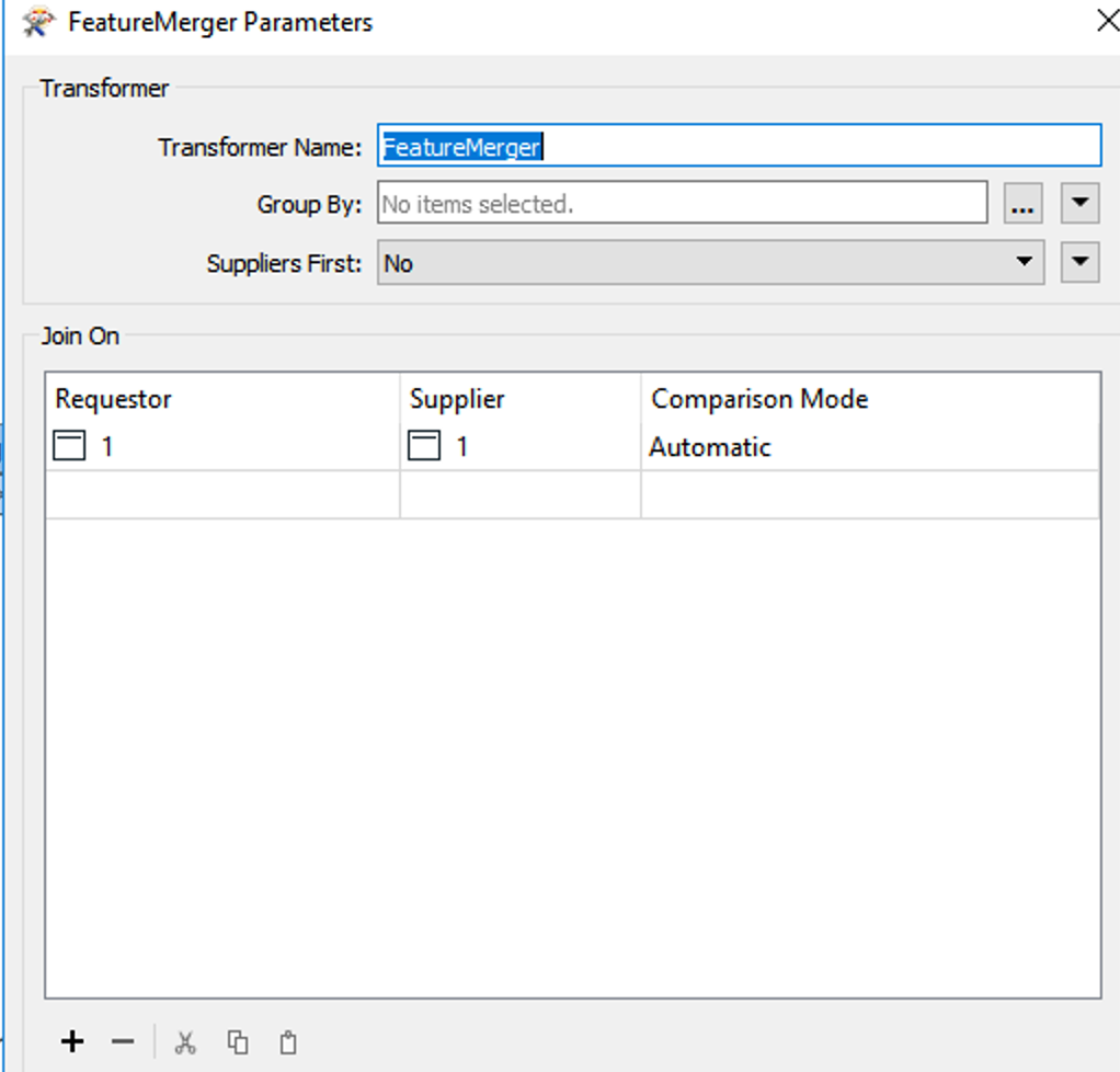

Ah ok!
In the real workspace, this is not possible because the pattern is coming from a DB. I used a Feature Merger with 1:1 matching to get it in one feature.
Thanks again for your help!

Or it is possible to use a Feature Merger with 1:1 to merge two streams.
