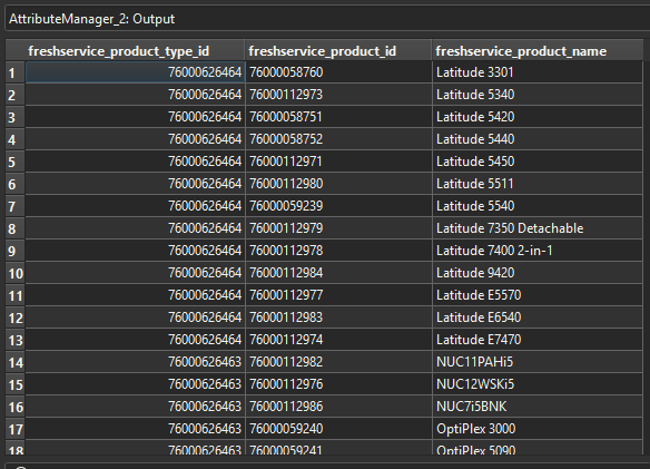

I have a feature set from Freshservice API of the available products in their asset system.
It’s mostly the Latitude and OptiPlex products I need to work with so the solution can work just for them.

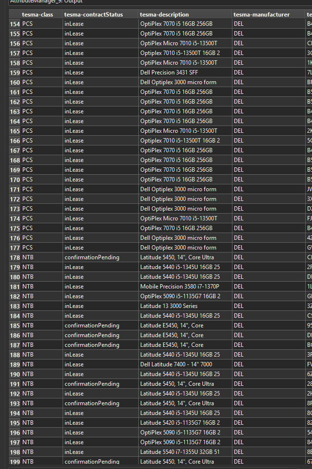

I need to match the freshservice_product_name to a feature set that I don’t control and isn’t consistent.
As you can see the tesma-description is a bit of a mess but it’s all I have to try match up the freshservice_product_name to.
Can someone point me in the right track of how they would tackle this?

Maybe the FuzzyStringComparer from FME Hub can be of help here.
geomancer
Forum|alt.badge.img+71
  • Apr 23, 2025 12:14 PM UTC
Maybe you can add an extra attribute in FME to the table containing tesma description, something like
  • Remove the word Dell
  • Remove the word Macro
  • Maybe some more actions
  • After that, keep only the first 2 words
Hopefully now only the two words remain that are present in freshservice_product_name.

Thanks everyone, I’m going to use a combination of all your suggestions.
I found I can bring in another data source matched on serial number with the model details formatted perfectly, but I’m still going to match them off with a search against the tesma-description as I’ve found some of the descriptions are for the incorrect family and model.
