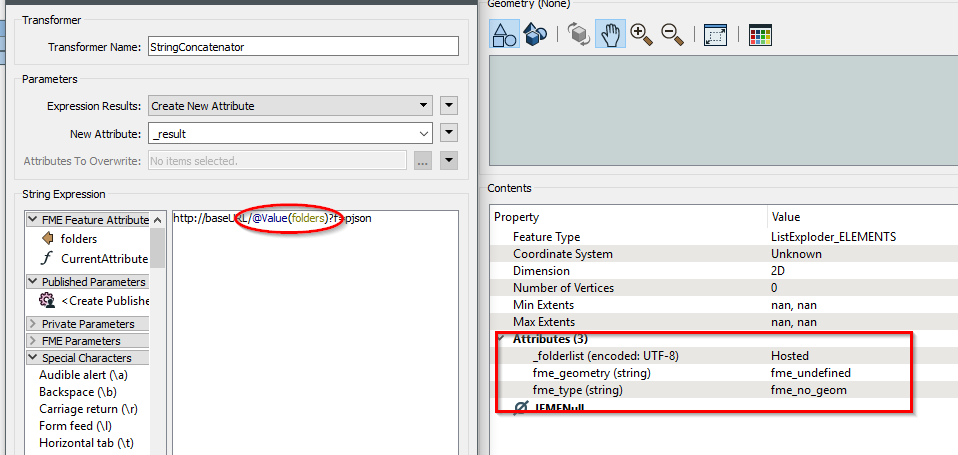

I had a look at the workspace you posted (thanks for making it runnable without any external dependencies!).
The issue is that the StringConcatenator references an attribute "folders" that doesn't exist at run-time:

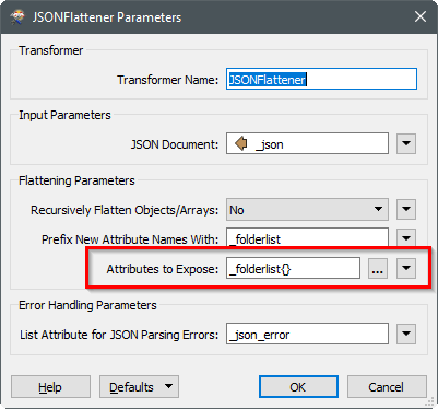

The right hand side is showing the feature attributes that's entering the StringConcatenator. As you can see in the square, there are no attributes called "folders". Maybe you want the value from "_folderlist"? If so, you need to fix the JSONFlattener setting before modifying the StringConcatentor accordingly:
