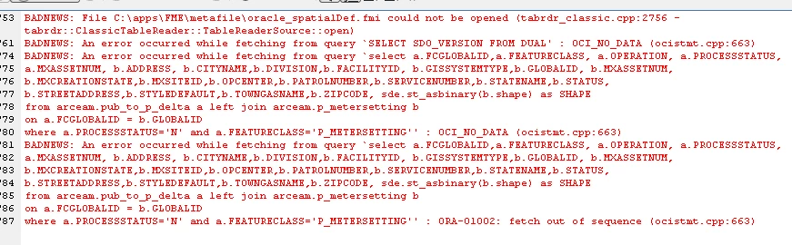

Hi David, I did the changes you suggested but got following errors

Hi David, I made the suggested change and got following errors

Try the exact same query in e.g. SQLDeveloper or TOAD and see if you get the same ORA-01002 error.

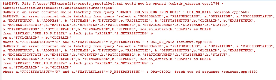

Hi David, I used WKB and WKT both and GeometryReplacer and this time I could at least see the geometry of the feature but a bunch of errors as below
I have seen that "fetch out of sequence" a lot when working with Oracle and storing in SDO Geometry. You have a bad geometry in there.
I have had to add a where a.shape.sdo_gtype = the correct geometry type. You can also use the SDO_UTIL.GETNUMVERTICES(a.shape) >= 1 for points and > 1 for lines.
