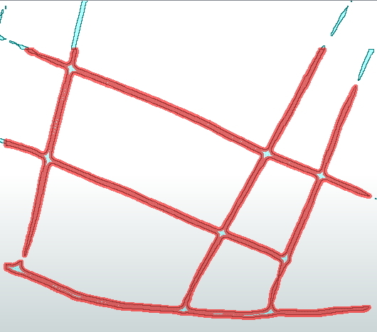

Hi All,
I have polygon layer for road feature which is generated from the raster layer . each polygon is form by multiple road polygons Now i would like split each polygon to it's sub component i.e. individual roads layer.
can somebody help me with this ?

Looking at the title of your issue, you might consider using a CenterLineReplacer. Often it will give you some shorter lines at the end as well, but those can be cleaned afterwards.
@larsatomkeere i tired to use that but it's not working with this. it generates te line with multiple small lines connected to main central line.

If you only want to keep the long lines and continue from there, you could use a deaggregator to extract the smaller lines and subsequent use a Tester or a TestFilter to filter out the smaller lines based on their @Length() value.

What version of FME are you using? There was a recent update to the CenterLineReplacer that I found very useful. I can't recall if it was 2018 or 2019 though - ah, I checked and it's 2019 (see this question: https://knowledge.safe.com/questions/31926/cleaning-gps-line-work.html). It does seem like it would solve the issue of the multiple small lines though.

@Mark2AtSafe i am using FME 2018.1 for this conversion
@lars_de_vries i tested with this using length option but it removes the line which are needed to create the central line also.

Right, I think you would need to use the 2019 beta to get the ideal solution with the CenterLineReplacer. In 2018 all I can really think of is to use a Bufferer with a negative value to make your polygons a bit smaller. Then the 2018 CenterLineReplacer might create the centre line without so many small, side lines.
