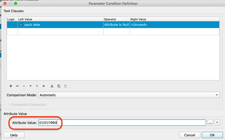

In the Parameter Condition Definition wizard after you have set the Test Clause there is a parameter at the bottom of the window that defines the new Attribute Value when this condition is met:

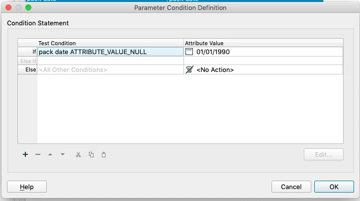

Then for the 'Else' statement leave it as No Action so anything that isn't Null is not changed meaning your overall Condition Statement will look like this:
