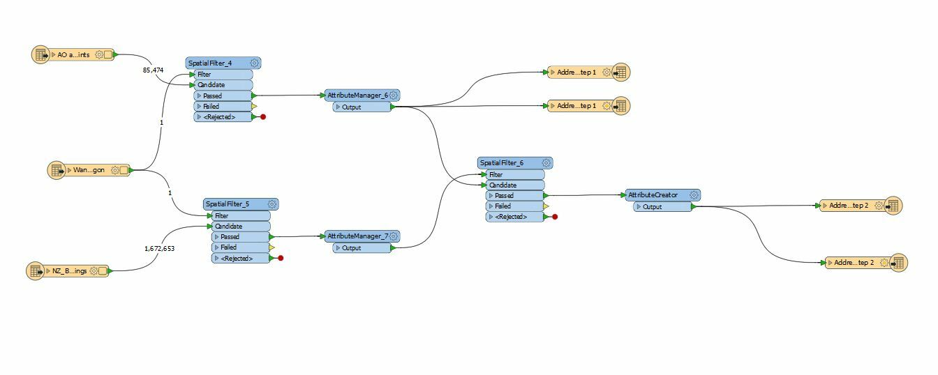

Hello,
The below translation aims to take regional address points and regional buildings layers and extract a certain study area based on a buildings polygon. I then try to use another spatial filter to link the address points to the buildings polygon it is located within. However I am struggling to find a way of saying 'IF address point is within polygon then take the property address and apply it to a new attribute in the building polygon'. Does anyone have any suggestions on how to link this together?
Best answer by ebygomm
A spatial relator, a point on area overlayer or a clipper would all be possibilities here. You just need to ensure that you have ticked merge attributes in the attribute accumulation options
  • Oct 12, 2018 2:09 PM UTC
mark2atsafe
Forum|alt.badge.img+59
The SpatialFilter too, will do that with the Merge Attributes parameter set.
