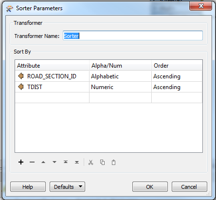

Hello all,
I am running FME(R) 2018.1.2.1 (20190319 - Build 18592 - WIN64)
I have a dataset of points (along a road) and I want to use the LineBuilder to create lines.
Each point has a ROAD_SECTION_ID (character field) which uniquely identifies the road.
Each point also has a TDIST (numeric field) which is the distance along the road.
I am trying to sort the points appropriately before they go into the LineBuilder. They should be sorted firstly by ROAD_SECTION_ID and secondly by TDIST.
However, the result of the sort is wrong. The features are sorted firstly in ascending order of TDIST, then in descending order of ROAD_SECTION_ID
I have reversed the order in the Sorter, but there is no difference
The outcome is that the LineBuilder does not work like it should
Best answer by nicholas
@danatsafe asked if my Reader was an ESRI file geodatabase, which it was.
I switched my raw data to a different format and my problem was solved.
@danatsafe also recommended I upgrade, but that is not a good solution for me (My workplace is using 2018.1 currently)

You might want to try the NaturalSorter transformer from the Hub. It offers the possibility to set a group -by which in your case is the ROAD_SECTIO_ID

@Nicholas
Sorting seems ok.
But u expect it to sort with the keys compounded.
In such cases I create a compound sort key.In this case csk is concatenation of the attributes.
You can also sort by tdist, aggregate by road_section_id and deaggregate.
Or counter by road_section_id and then use this counter as first sortkey (rather than road_section_id;
you would be replacing a string by a number)

Just to get some more info, what happens if you only sort on ROAD_SECTION_ID ascending? Do you get the expected result below?
10M
10M
10M
10M
10N
10N
10N
10N
Yes, I I sort only on ROAD_SECTION_ID (Alphabetic, Ascending) then I do get the expected result as you describe.
Also, if I sort only on TDIST (Numeric, Ascending) then I get a proper result

My problem is when I attempt to sort on two attributes (first by ROAD_SECTION_ID, then by TDIST)
fmelizard
Forum|alt.badge.img+21
  • August 30, 2019
Hi @nicholas Are you reading from a geodatabase? If so then this problem with the Sorter was just recently fixed. Please try the latest 2019.2 beta from https://www.safe.com/support/support-resources/fme-downloads/beta/
Yes, I am reading from a file geodatabase.
I cannot upgrade to 2019.2 I need to maintain version parity with my workplace's FME server.
I will instead experiment with saving my dataset in a different format. Maybe a CSV or oracle database?
CSV will work. Let me know if you have trouble with an Oracle database.
CSV did work :-)
