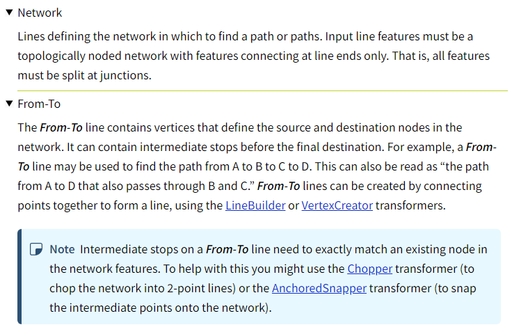

Hi ​@gbcfgeo2025 ,
Network lines must be topologically connected. Not only Snapper/AnchoredSnapper but also TopologyBuilder might be necessary to construct networks.
Regarding From-To lines, note that every vertex of them should exactly match a node of network.
See also the Help for ShortestPathFinder to learn more.
