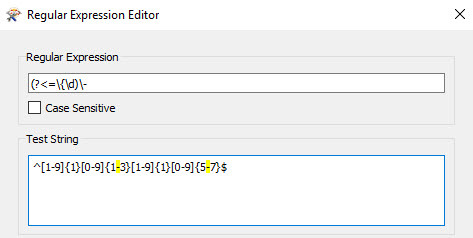

I guess you want to replace all dashes which are in the curly brackets with "," (comma).
You can use the expression below:
(?<=\{\d)\-

Thanks a lot, both answers were very helpful!
