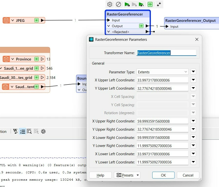

danilo_fme
Forum|alt.badge.img+58
  • Sep 29, 2025 9:35 AM UTC
Hi ​@abnan0001
I used the transformer RasterGeoreferencer in your source JPG:
Thanks in Advance,
Danilo

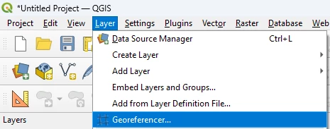

nielsgerrits
Forum|alt.badge.img+67
This is not something I would fix using FME. For georeferencing my go to tool is QGIS, it has a great georeferencing tool.

Hi ​@abnan0001
Thanks in Advance,
Danilo
Thank you
Source to georeference them using extent layer because. Location is actually Saudi Arabia .
Need your kind guidance to resolve it.
