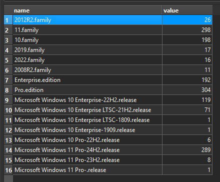

Hi,
I’ve read through other row to column posts but can’t seem to get it to work.
Pretty simply I want the name values to become column headings and their value below them.
I feel like this should be an easy one but just can't get it to work.

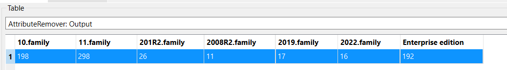

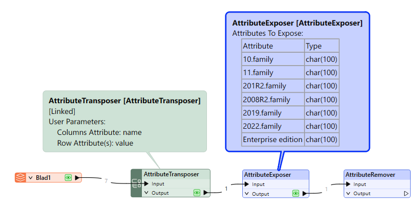

Dear ​@cg-wcc
I made a small copy of your data and made this small workspace which seems to do your job:
Please let me know if you need further support :)

This is perfect and so easy thank you. That community transformer is great.
