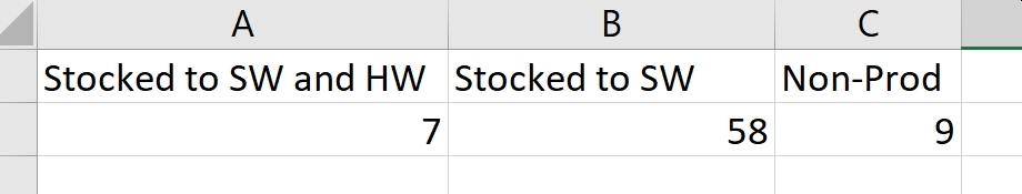

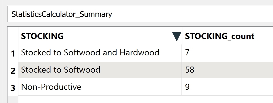

I have summary output coming from the StatisticsCalculator that I would like to rearrange such that row values become column headings with values for these coming from the statscalc count output (see input and end result images below). I've tried AttributePivoter, AttributeTransposer without success.

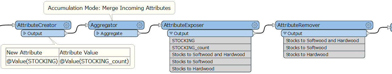

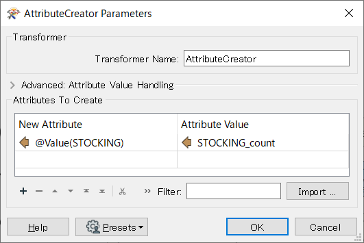

Firstly create a new attribute whose name is equal to the value of STOCKING and assingn the value of STOCKING_count to the new attribute, with the AttributeCreator as in:
Then, aggregate all the features using the Aggregator with Merge Incoming Attributes mode.
Finally expose the new attribute names (originally equal to values of STOCKING) with the AttributeExposer, then remove unnecessary attributes optionally.
The workflow looks like this.

Terrific @takashi!
One thing I did have to do was manually type in the new attribute names (originally equal to values of STOCKING) in AttributeExposer because I didn't see them as attributes to expose.
Thank you.
