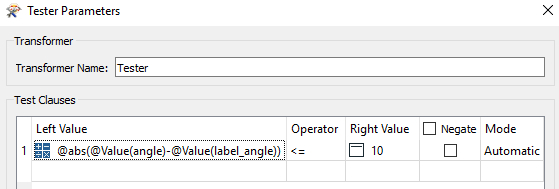

Hello,
I am trying to validate the angle of a range of lines to see if they are within plus or minus 10 seconds of a label on the line.
I was looking for something similar to the Attribute Rounder but that allows you to specify a value rather than decimal places.
The Attribute Range Filter seems close but the values are in a list.
If anyone has some suggestions that would be very much appreciated.
Regards
Dean
Best answer by ebygomm
You can use negative numbers in the decimal places parameter in an attribute rounder if you want to round to the nearest 10/100 etc.
If you want to test whether something is within plus or minus 10 seconds though I'd use this sort of expression in a tester
  • Jul 5, 2019 6:39 AM UTC
deanhowell
Forum|alt.badge.img+24
  • Jul 8, 2019 12:28 AM UTC
Thanks again @egomm, that is very close to what I need to do. Thanks for taking the time to put together the screenshot as that helps a lot.
