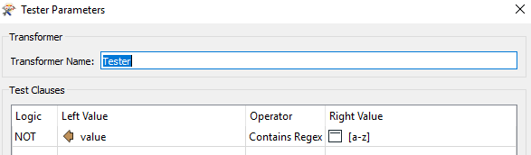

If it finds [a-z] it's a fail. As simple as that? :)

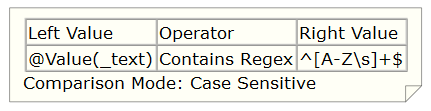

This setting could work as expected.

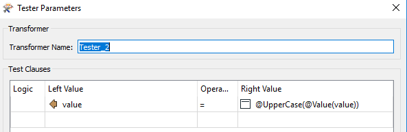

I'd be tempted to ignore regex and do the test like this, if it's a possibility you'll have apostrophes, hyphens or similar in your input
e.g. THIS SHOULDN'T FAIL
But this should work as well - only values without any lowercase letters pass
Thanks @danullen, that worked perfectly, keeping it simple :)
Thanks also @ebygomm, that is a much more elegant solution. I love that there are multiple ways to get the same solution.
