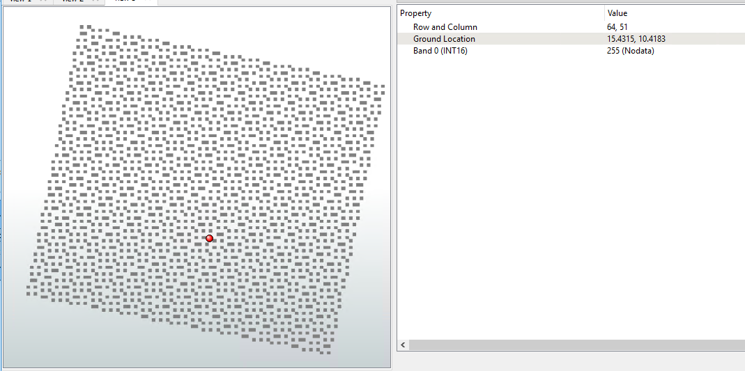

Is it possible in fme to keep it as a raster with it's correct geoloction for each pixel without having to convert it to points in fme? You used the vertex creator in order to assign it to the correct lat long but I'm not sure what raster transformer would have this functionality?
When attempting to convert the points back to a raster using the image rasterizer, it doesn't come out quote right.
